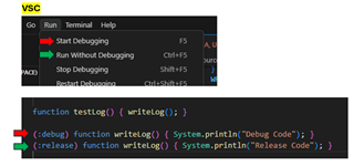

This isn't working. In VSC at least, the (:debug) function is called regardless of running it with Start Debugging or not.
Is there a way to select in VSC if I run my code with the debug or release code blocks?
My desire is to compile a release edition with a smaller memory footprint, but run with the debug blocks in VSC when needed.
  • These are two different things. The "Start debugging" and "Run without debugging" means compiling the program, loading and running it in the simulator and then either have a debugger attached or not. If you decide to run it in a debug session, you can set breakpoints which eventually get triggered so you can inspect your program step by step for example.
    The (:debug) and (:release) annotations mean which code block gets compiled into the program binary depending on if you compile with the -r (or --release) flag or not. Compiling with the -r flag is necessary to build an .iq file that you can upload to the IQ store. So in short: Code with the (:debug) annotation will not be part of your .iq file and is exactly what you are looking for.

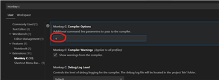

    The simple solution to run the release version of your code in the sim is to temporarily add the "-r" flag to the compiler options. It's very strange that you mentioned you would do this for exporting a project (even though it's not necessary and has no effect), yet you completely missed the hint that you should do this for building a project normally, if you want to test your release code in the sim.
    To be clear:
    - CTRL-SHIFT-P > User Settings
    - Add "-r" to Monkey C: Compiler Options
    Since you already had the idea of using "-r" flag (but only for exporting), again this is something you could have easily tried for yourself, based on the hints that were already given. It's literally the same idea that you already had for exporting the project, but applied to running it in the sim.
    Unless of course you had a stubborn assumption that there's absolutely nothing you can do to prevent the sim from running the debug version, in which case why would you be asking how to do it?
  • TL;DR just add "-r" to the compiler options if you want to test the release version in the sim. The very first reply basically says so, and you yourself had the exact same idea, except only for exporting the project (where it isn't even necessary).
