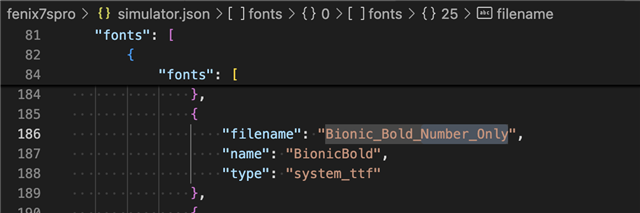

    Having said all of that, the filename for the BionicBold font that the sim uses is "Bionic_Bold_Number_Only". No other font filename contains the string "number_only" though. Lots of font filenames do contain the string "number" without "only".
    This can be seen in the "Font" column for the device reference page for fenix7xpro (for example):
    https://developer.garmin.com/connect-iq/device-reference/fenix7xpro/
    The device config files show the same (in ConnectIQ\Devices on your computer):
    (It isn't surprising that they say the same thing as they're likely genned from the source)
    If you're seeing different behaviour with drawText and drawRadialText in the sim, and with the sim and a real device, I would report a bug.
