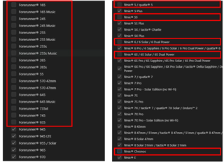

I'm trying to figure out which Watch devices my field will work with.
There are several disqualifiers.
First, there is the CIQ Memory Limit. For example, the Fenix 5 has a limit of 28500 bytes.
I'm also seeing this error: PRG generated exceeds the memory limit of app type 'datafield' for device id 'fenix5': 72576 bytes
Is there some resource file I can search to find these limits, rather than running every watch in the simulator to find these?
Thanks!

  • Thanks! Most Fenix watches will work, and only the more recent FR watches will work. Many of the more recent Venu, VivoActive, Approach, Instinct, Epix, D2, Descent, and MARQ series will also work. We're good with not supporting the really old and low memory watches - just need to know which ones have a memory limit < 64kb.
