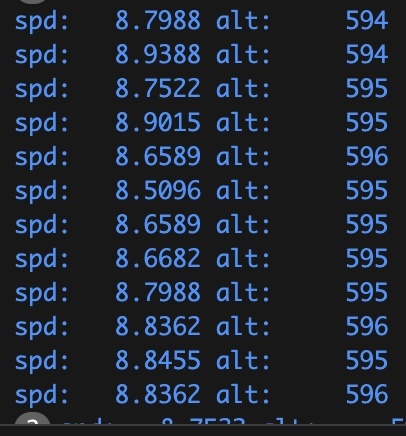

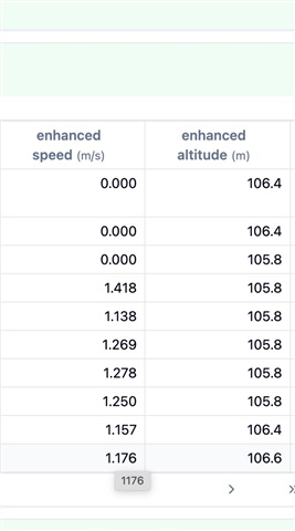

When I replay FIT files that I recorded, the values (speed and altitude specifically) are way off.  I used https://www.fitfileviewer.com/ to check the values. In "user" mode the viewer shows the values I expect.
What am I missing to get FIT file playback to work as expected?
 "user" and what I expect on the left and sim on the right:

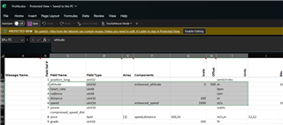

    If you look at profile.xlsx from the FIT SDK, you will see that:
    - for enhanced_speed: scale = 1000, offset = 0
    - for enhanced_altitude: scale = 5, offset = 500
    Therefore:
    - for enhanced speed, an encoded [raw] value of 1418 translates to a decoded [user] value of 1418 / 1000 = 1.418
    - for enhanced altitude, an encoded [raw] value of 3029 translates to a decoded [user] value of 3029 / 5 - 500 = 105.8

  • When I replay FIT files that I recorded, the values (speed and altitude specifically) are way off.
    I'm not sure about this part tho. I don't know if it's a bug in the sim or not.
  • How are you loading the FIT file and playing it back?
    What works for me: If I select Data Source = "FIT/GPX Playable File", load a saved FIT file from a real activity recorded on my FR955, and press the play icon, the data seen by my app (simple data field) roughly matches what's in the FIT file. Based on fitfileviewer, ActivityInfo.currentSpeed roughly matches enhanced_speed in the Records table (although currentSpeed somehow has additional decimals of precision), and ActivityInfo.altitude roughly matches enhanced_altitude in the Records table (except it's offset by about -18 m). Not sure what's going on with the altitude. [*]
    What doesn't work for me: If I select Data Source = "Workout FIT File", and load the same FIT file from a saved activity, the data doesn't match what's in the FIT file. It seems that in this case, I just get simulated data. I think this makes sense, as in this context, "Workout" means a programmed structured workout, not a recorded activity. I do think it would be better if the sim displayed an error if you select a FIT file type which is different than the actual type of the file you load.
    [*] EDIT: others have noticed the sim starts off with altitude of -18 m instead of the starting altitude in the FIT file. Not exactly the same thing (absolute value of -18 as opposed to relative offset of -18), but it can't be a coincidence that -18 shows up in both cases.
