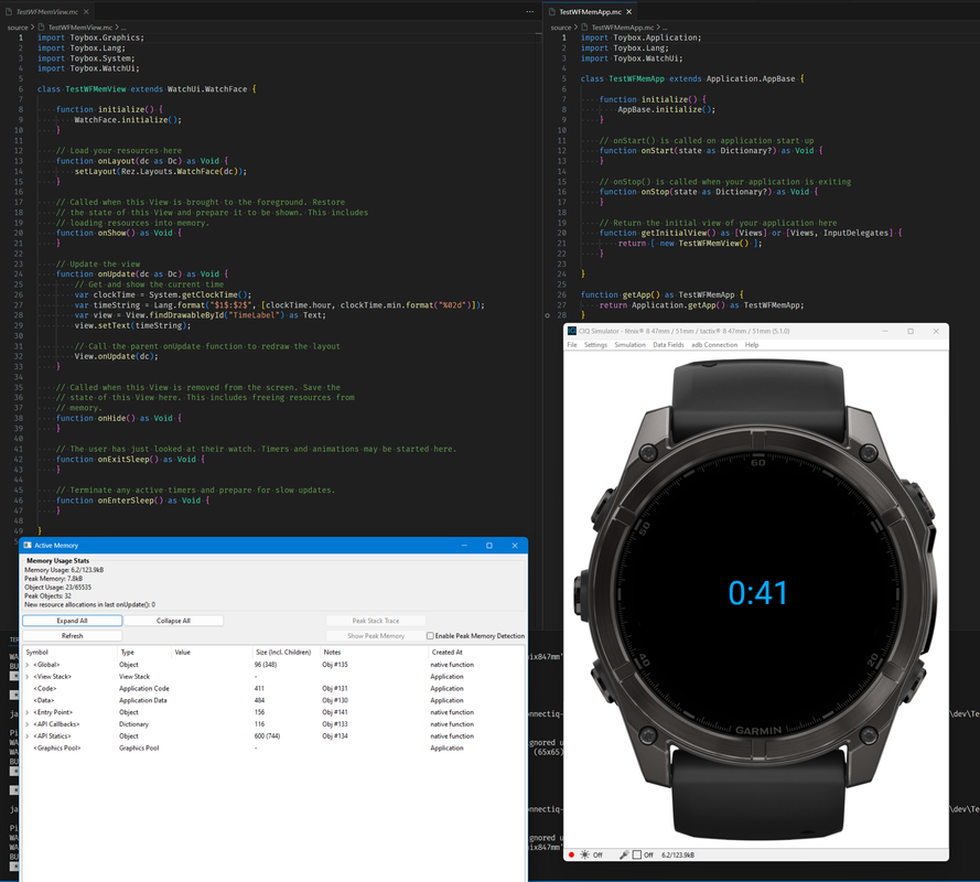

  • I cannot explain what you are seeing with your own app and your own tests, but:
    - I created a new watchface by using the Monkey C: New Project command and selecting Watch Face > Simple
    - I built and run the project for fenix847mm and venux1 - the memory usage is nearly identical: 6.2 kB in each case. If you look closely, there is a small difference of 12 bytes in the <API Statics> section, so I imagine if you looked at the precise amount of memory used via the appropriate API call (getSystemStats().usedMemory), you would see a difference of roughly 12 bytes (perhaps rounded up to the nearest 8 bytes)
    fenix847mm:
    (click to enlarge)

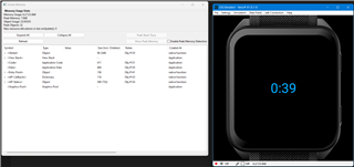

    venux1:
    (click to enlarge)
