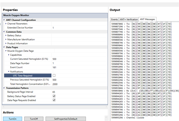

    You may have a look into the MO2Display Sample from the SDK:
    // Create and populat the data payload
    var payload = new [8];
    payload[0] = 0x10; // Command data page
    payload[1] = 0x00; // Set time command
    payload[2] = 0xFF; // Reserved
    payload[3] = 0; // Signed 2's complement value indicating local time offset in 15m intervals
    // Set the current time
    var moment = Time.now();
    for (var i = 0; i < 4; i++) {
    payload[i + 4] = ((moment.value() >> i) & 0x000000FF);
    // Form and send the message
    var message = new Ant.Message();
    message.setPayload(payload);
    GenericChannel.sendAcknowledge(message);

    On page 22 and 23 it describes Broadcast and Acknowledge messages. To the best of my knowledge, broadcast data can only be sent by the Master unless it's requested. Also, CIQ devices can not currently be setup as the master. See this thread. I'm not familiar with how a request for broadcast data can happen, but it seems like sendBroadcast might not be what you are looking for.
    Which ANT+ profile are you using? Is the data that you are trying to send from the watch to the ANT+ device defined as an acknowledge message in the profile? For example, Data Page 16 is defined in the MO2 profile as an acknowledge message to be sent from the watch to the sensor. This lets the watch send the current time to the sensor.
    Also, an ANT+ message is just an array of bytes.
