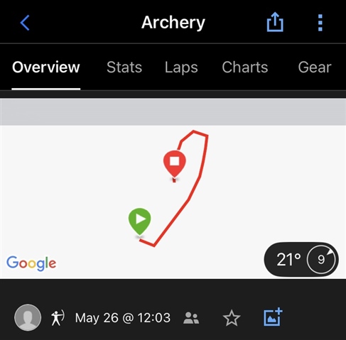

  • OK I am still digesting this. A related problem is I can't seem to programmatically set the name of the activity at the top of the screen in Garmin Connect. I have a weird situation where seems to be choosing some random name not related to any of the 3 options in the call to createSession().  What is this value, not activity type or subsport or name??
    Clearly it's the activity/sport type as far Connect knows.
    Not only does it say Archery at the top, there's also a little icon of a stick figure holding a bow, next to your profile pic, at the bottom of the screenshot.
    I bet if you tap the 3 dots button and select Edit Activity, the Activity Type field will say "Archery".
    I can't explain why it says Archery in your case tho. Could be a bug, but I'm not sure.
    You can easily verify what I'm saying a couple of ways:
    - look at some activities recorded by native activity profiles and notice how the text at the top of the activity in the Connect app matches the sport type [and the icon next to your profile pic represents the sport type]
    - edit any activity to set the Activity Type to Archery and note that it will now look similar to the screenshot you took (you can change it back with no loss of data)
