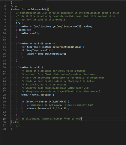

  • As jim_m_58 said, the value returned by Weather.getCurrentConditions() can be null. Additionally, CurrentConditions.temperature can be null.
    Both of these things are explicitly stated in the API documentation:
    https://developer.garmin.com/connect-iq/api-docs/Toybox/Weather.html#getCurrentConditions-instance_function
    getCurrentConditions() as Weather.CurrentConditions or Null
    developer.garmin.com/.../CurrentConditions.html
    var temperature as Lang.Numeric or Null
    If you enable type checking, the type checker will prevent you from using these values without checking for null. This would've avoided the crash in the first place.
    Finally, there is a subtle problem with your conversion to Fahrenheit. As seen above, CurrentConditions.temperature is Numeric, which means it can either be a floating-point value (Float/Double) or an integer (Number/Long). If it's an integer, the calculation will not work as expected. Since wxNow * 9 will be a multiplication of 2 integers, the result will be an integer, and that result will be divided by 5, which is also an integer. Therefore, the division by 5 will be performed as integer division, which throws away the remainder and returns an integer / whole number as a result. This is clearly not what you want - in this case you want a fractional / floating-point result. The solution is to make sure one of the numbers involved in the division is a float.
    Here's a modified version of your code which addresses the above issues (missing null checks, and fahrenheit conversion issue):
    EDIT: Old and busted sample: https://pastebin.com/BFRtqdMN
    There is another potential problem where getComplication will throw an error if the given complication is not found. I'm not 100% sure if this is possible in your case (since I can't see the full context). In my modified version of your code, I didn't bother addressing it.
    EDIT: new and better sample:
    https://pastebin.com/Rfu6GeKb

    The -99 was part of my “why isn’t this working” process.  I was trying to force it to show -99 if all else failed.
    I have corrected the equation for consistency.  I also decided to do all the error checking and correcting in the functions that “use” the Complications.
  • No problem! You may have noticed my example has a subtle crash bug if hasWx is false. Even though you won't use the code, I'll update the sample to avoid that bug and to not use -99.0 at all.
