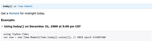

  • I think the documentation also reflects this behaviour [although perhaps it isn't clear at first glance]
    631087200 is Sun Dec 31 1989 00:00:00 GMT-0600 [Central Standard Time]
    If I were in charge of writing the docs, I probably would:
    - clarify that "midnight" here means "beginning of day" [technically every day has two midnights]
    - clarify that CST is UTC-6 / GMT-6
    - convert 631087200 for the reader instead of making them convert it themselves
    [3/4]

  • Also using 31 December as an example makes it even more confusing. I bet some think that probably the midnight here means the moment when people open the champagne bottles between the old and the new year. Any random date would have been better...
    I think I already covered this:
    It might be intentional though, because if you actually convert the returned value in the example, you'll see that the output year is the same as the input year, which reinforces the fact that it's midnight (beginning of day), not midnight (end of day).
    Again, one problem is that Garmin doesn't tell you what the returned value in the example corresponds to, but instead expects the dev to convert it themselves.
    Instead of simply writing:
    // UNIX epoch 631087200
    They should've wrote something like:
    // UNIX epoch 631087200 - December 31, 1989 12:00 am CST (UTC-6)
  • However, I'm gonna guess that the reason December 31, 1989 was chosen because the Garmin epoch starts on that date at midnight (UTC). (Midnight as in beginning of day)
