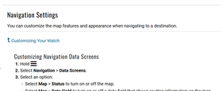

    I'll just say that by these definitions, Fenix 8 is a "button-based" watch. But Fenix 8 has notably gotten rid of the behaviour which opens the system settings by scrolling past the end of the current context-sensitive menu, and has restored the old behaviour where system settings is just another menu item which opens a submenu when selected.
    I disagree that opening a 2nd menu when the user scrolls past the bottom of the current menu is any more or less intuitive/natural whether the user scrolled via buttons or touch. Either way, it's unintuitive and to the end user, it just seems like one big menu (instead of 2 separate menus). This can be seen by the confusion that arises when the activity menu and the settings menu both have an entry called Navigation, and users sometimes select the wrong menu item since the activity menu and settings menu are "combined into a single menu" when you hold the UP button during an activity. This is also seen by the fact that Garmin is unable to properly document how you would open the system settings Navigation item when you are currently in an activity. (The manual just ignores this issue completely.).
