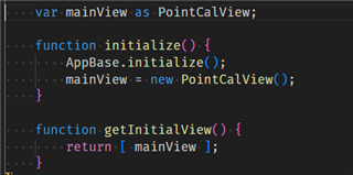

  • Hi everyone,
    Just wanted to follow up and say thank you FlowState for the insightful explanations!
    The issue is now resolved.
    The solution that worked for me, as suggested, was to make the mainView member variable in my AppBase subclass non-nullable and initialize it directly in the initialize() method of the PointCalApp class, rather than in getInitialView().
    class PointCalApp extends Application.AppBase {
    var mainView as PointCalView; // Non-nullable
    function initialize() {
    AppBase.initialize();
    mainView = new PointCalView(); // Initialized here
    System.println("PointCalApp initialized. mainView created.");
    function getInitialView() {
    System.println("Returning mainView instance.");
    return [ mainView ]; // Now 'mainView' is guaranteed non-null
    // ... rest of the class ...
    This indeed fixed the Cannot override '$.Toybox.Application.AppBase.getInitialView' with a different return type error I was getting with SDK [Votre_Version_SDK, ex: 8.1.1] when targeting the Forerunner 955 (fr955). It seems the compiler's type inference for nullable member variables in the return [ mainView ] context was the core of the problem.
    Thanks again for the great community support!
