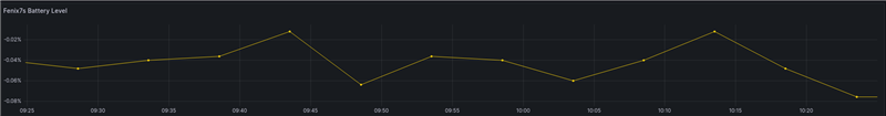

  • I've done something like that. The plot is showing the difference between two succeeding System.getSystemStats().battery-calls. The first plot is with WatchfaceDelegate enabled and in the second WatchfaceDelegate is commented out in my WachfaceApp. Otherwise identical. Data is collected every 5min. It seems that the "baseload" is just higher as the first plot never reaches the low levels of the second.
    I would love to understand how onComplicationChange is affected by touch as the code is the same for both versions! This might be the obvious thing I might have missed.
