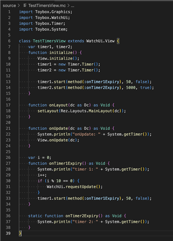

  • Not sure. I tried recreating your problem with your actual code in the sim, but it looks like I have to set up some site URL in app settings, so I didn't get to the part where the "site view" is displayed.
    I tried to create a toy example with two timers which fire every 50 ms and 5000 ms, respectively, with WatchUi.requestUpdate being called twice per second, but I didn't see anything like the problem you described. The timer callbacks and onUpdate are called without any noticeable "gaps" (def not 2 seconds worth).
    [Yeah, I realize it's possible that my example doesn't really capture your use case :/]
    To use this example:
    - create a new watch app project called TestTimers
    - replace the view file with this:
    https://pastebin.com/fsZ8gstP
    I can only guess that the delay might have something to do with what's actually being executed in onUpdate or one of the timer callbacks?

  • To use this example:
    I now ran your example, and it works fine also in my environment and with the device I use for testing.
