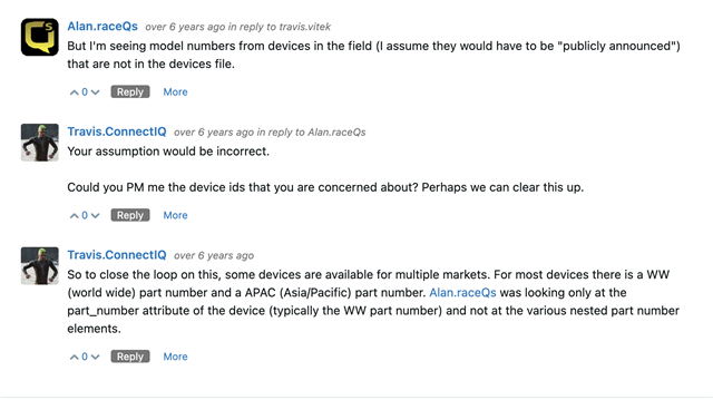

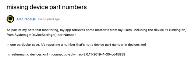

    Each partNumber entry is uniquely identified by the value of the number key (e.g. "006-B2337-00") which is the part number itself, not firmwareVersion.
    In general, a partNumber entry is information about a specific part number, not a specific firmware version.
    Therefore, for each device listed in the manifest, the build produces a separate bytecode file for every firmware version defined in compiler.json. The variation in firmware versions per device, from one to seven, is likely related to hardware differences.
    It's about part numbers, not firmware versions. Each part number has its own firmware version number, but the firmware version number itself is not the determining factor in the essential differences between part numbers. (This can especially be seen with devices that have multiple part numbers, but some or all of the part numbers have the same software version number.)
    A part number is basically a software variant of a given hardware model. So it's not really about hardware differences at all: for example, most older devices have 2 part numbers - one for WW (worldwide) and one for APAC (Asia-Pacific), and the only real difference between the part numbers is the language support (and, usually, the firmware version).
    e.g. fr935 is one hardware model with two part numbers (software variants which only differ by language support and firmware version):
    - 006-B2691-00: WW
    - 006-B2833-00: APAC
    (see below for more information)

    To make matters even more interesting, some part numbers also indicate a unique variant of a CIQ device (beyond WW vs. APAC). For example, venu2s has 4 part numbers, which correspond to:
    - 006-B3704-00: "plain" Venu 2S WW
    - 006-B3949-00: "plain" Venu 2S APAC
    - 006-B4175-00: Mercedes-Benz Venu 2S WW
    - 006-B4181-00: Mercedes-Benz Venu 2S APAC

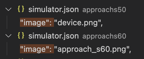

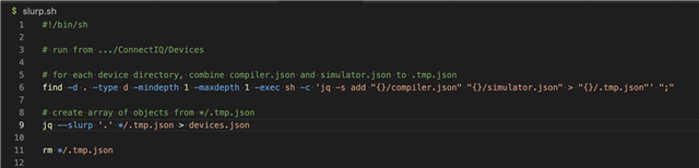

    I'm currently facing a challenge with simulator.json. Unlike compiler.json, it lacks the deviceID, making it difficult to identify devices when slurping them into an array of objects.
    The closest identifier I've found is the image filename ("image": "fenix7.png"), which seems a bit dodgy.
  • I'm currently facing a challenge with simulator.json. Unlike compiler.json, it lacks the deviceID, making it difficult to identify devices when slurping them into an array of objects.
    Note that each device has its own folder, which is named after the device id itself.
    e.g.
    ConnectIQ/Devices/fr955/compiler.json
    ConnectIQ/Devices/fr955/simulator.json

    There's many other files in each device's folder, such as svg and png files which cannot reasonably be expected to contain the device ID at all.
    Even if the device folders were not named after the device ID, it seems like that would not be an insurmountable obstacle to associating the device ID with all information contained within a device folder, as long as at least one file in the device folder contains the device ID.
    To be clear, you have full control over the process of reading device information and writing it to your own data structures: it's up to you to write the device ID in places where it's necessary, or perhaps to structure your data so that all data associated with a given device / device ID is grouped together.
    Nobody forces you to:
    - ignore the device folder name when reading device data
    - apparently read compiler.json and simulator.json independently of each other, and write them to completely independent objects
