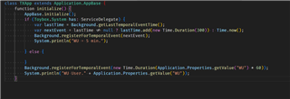

  • Here is the full code:

  • But still, you can only detect a failed web request in the callback of the web request...
  • There is no problem there, at least I don't see anything. The problem is that the data recovery doesn't happen every time and at the required interval.

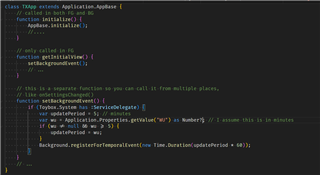

  • Is this literally your code? You are calling registerForTemporalEvent twice, and the second call is cancelling the first one.
    Here's what it looks like after formatting:
    The second call is this:
    > Background.registerForTemporalEvent[new Time.Duration[Application.Properties.getValue["WU"] * 60]];
    If the "WU" value in properties is less than 5, then the second call is probably failing because you need to pass in a value of 5 minutes or greater [and maybe the first call is still cancelled], so you don't have a temporal event scheduled at all. On the other hand, if the second call fails and the first call is *not* cancelled, then your temporal event will only run once.
    If the "WU" value is something like 60 that could explain why you don't see any updates for a whole hour.
    Also, registerForTemporalEvent seems to be called in both the background process and the foreground process, but it should only be called in the foreground.
    Maybe try something like this:

    Try the suggestion I posted above as a starting point and see if it works better for you.

    I think it would make sense for "WU" to be an optional numerical setting (so the user can either enter a number or leave it blank). And if it is, then the example I posted should already work for what you want, except for the part about doing different things whether bluetooth is enabled or not.
    Personally I think the bluetooth part is too complex if you are already having problems such as "When I try to call Refresh weather, sometimes it only updates after an hour." I also think the bluetooth part is kind of unnecessary. I get that the idea is to refresh the weather ASAP as soon as bluetooth is re-enabled, but if the user is already willing to wait X minutes between updates, they should be ok with waiting another X minutes after turning on bluetooth.
    So again, I would start with something like the suggestion I posted above. Once that works, you can look at the bluetooth logic.
  • Yes, your suggestion works better. I just wanted to do this: when importing WF to the watch, the default value in the refresh rate setting is off. the default value for loading weather is 5*60 (so that you don't have to wait long for weather data), then if I change the update time (number) in the string (wu), the weather update will be created according to the string-setting time. Among other things, maybe it lacks logic, but I wanted to achieve that if I have Bluetooth turned off and the user-set time (wu) after the update evaluates that Bluetooth is off, the next update will be 5*60, and after five minutes, if Bluetooth is turned on again, the weather will be updated according to the string setting, in our case "WU", where wu represents a number.
