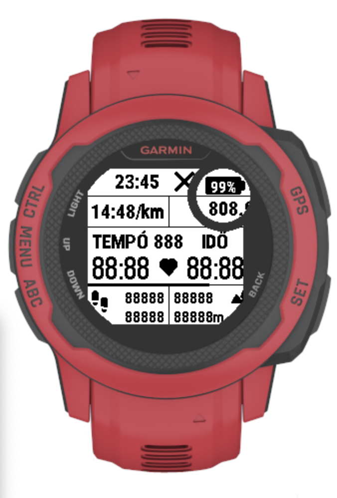

It turns out that the reason for this is that the sub-screen has a 7 pixel bump on the right compared to the right side of the "big screen" area.
This has a funky effect when some of the visuals are positioned relative to the width, because in the watch-app the right side is "missing":
datafield (right side of the time (88:88) and the mount icon are correctly positioned):
watch-app (right side of the time (88:88) and the mount icon are IN-correctly positioned):

    I see that the datafield example is for a 2 field layout (it's not like it could be anything else), with the 1st field (big) covering the entire screen except the subscreen, and the 2nd field (small) covering the subscreen.
    As annoying as this inconsistency is, it kinda makes sense given that a DF can't draw on the I2 subscreen but a device app can.
