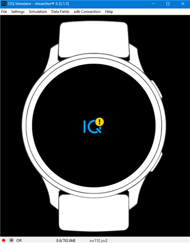

Then in the sim, starting at the indicator on the right, I drag to the left to trigger this.  The sim does seem to be kind of touchy as far as speed and angle, so it might take a couple tries to get it right the first time.
  • And what you called "not touchy" to me it looks like some of the areas are not well defined in the simulator.json. Opened bug for the buttons: https://forums.garmin.com/developer/connect-iq/i/bug-reports/bug-vivoactive6-button-area-inconsistent-with-visual-in-simulator

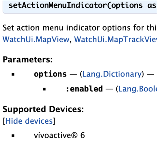

  • I noticed that setActionMenuIndicator's documentation doesn't list devices, just that it's from 5.1.1. Not sure if this means that soon lot of existing devices will be upgraded and also work like that, or if later they'll add a devices section to the docs...
  • But it does list devices, which is why I argued in the other bug report thread that setActionMenuIndicator was added out of necessity, not convenience. (CIQ apps for va6 need a way to provide context-sensitive menus, since onMenu is gone)

  • It does seem kind of rushed, given the generic va6 image in the sim. It looks like a placeholder image from a preview device
