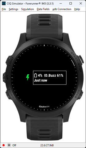

I am just testing my glance on different devices and noticed a difference between the FR945LTE and all the other devices I tested so far. Below two screenshots, the first is the FR945, the second the FR945LTE. The border indicates the complete dc area of the glance.
On the FR945LTE there is no spacing to the left, and also to the right it goes further.
What do you think, is the difference a bug in the simulator, or does the FR945LTE really have a different implementation of the glance?
  • I don't have neither of these devices, but my guess would be that there shouldn't be any difference in how things are displayed on real device, thus probably it's a bug in the simulator. You'll be able to see what's in the simulator.json of these devices, and probably if you edit if to match the layout to the other one then the simulator will display them in the same way. After you check this it might be a good idea to open a bug report so Garmin will be aware (and maybe even fix the json in the next SDK release ;)
  • I'll just report is as a bug, this one device is not so relevant for me to be tinkering with the simulator.json. I'll just assume that it will work, as long as no user reports back otherwise.
