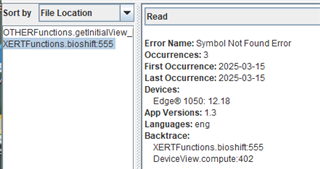

About 5 mins into an activity, my stable data field now crashes with Symbol Not Found, at line numbers with no issues. I see this reported by others for Watches too. I hope selecting SDK 7.4.3 fixes this, but then there is a reported issue that I can't build my apps for API 5.1 devices with any SDK lower than 8.1. I don't believe that is true... we'll see.

    Are you sure that on your line 555 it's not the call itself, but something you are trying to use as a parameter to the call? Also Era can be off a line or two at times, or was the case in the past.
