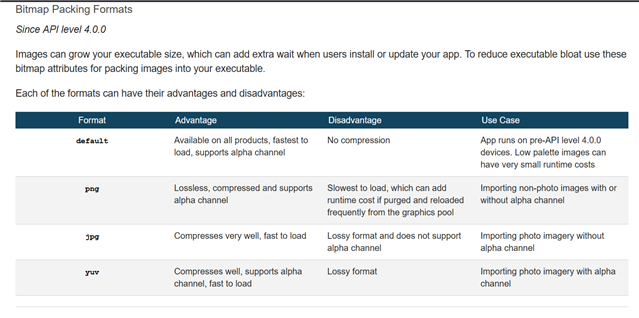

    Prior to CIQ 4, the resource compiler would convert all images to uncompressed bitmaps.
    Starting with CIQ 4, you can specify the packingFormat attribute on bitmaps to control the format that's ultimately used in the PRG:
    https://developer.garmin.com/connect-iq/core-topics/resources/
    https://developer.garmin.com/connect-iq/core-topics/resources/#bitmappackingformats
    In your case, I would guess one of three possibilities:
    - you are building for a device with CIQ < 4
    - the resource compiler isn't using png as a packing format
    - even if the resource compiler is using png as a packing format, it's not using your original png (perhaps it converts your image to uncompressed bitmap, then converts it back to png)
    You could always set the packingFormat to png and see if it makes a difference though.

    I am building for older devices as well, for example the Fenix 6 with API 3.4.0.
    So if I understand it correctly, in this case, the resource compiler does not support any of those newer packing formats, takes the PNGs, and converts them to some internal, uncompressed format. Hence crushing the input JPEGs does not make much of a difference.
    I will still try to include the packingFormat so that it can be used for the newer devices.
