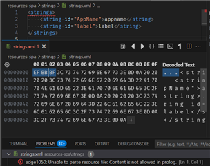

Now when I try to build the watch face for a Descent MK3 43mm device in Visual Studio Code I get an error:
ERROR: descentmk343mm: C:\Users\pbeesley\OneDrive\Personal\eclipse-workspace\GMT4M2\resources-deu\strings\strings.xml: Unable to parse resource file: Invalid byte 1 of 1-byte UTF-8 sequence.

  • That certainly fixed my problem. When I upgraded to API 8.1 in VS the encoding seems to have changed. Some files were UTF-8 with BOM and others UTF-16 LE. I hadn't noticed on the status bar that the encoding had changed. Saving the file back as UTF-8 has fixed it an now all the 5.0 and 5.1 API devices build correctly with SDK 8.1.
