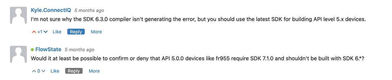

    A Garmin employee confirmed that CIQ 5.x devices require newer SDKs, too.
    https://forums.garmin.com/developer/connect-iq/i/bug-reports/building-ciq-5-devices-e-g-fr955-in-sdk-4-2-4-results-in-error-claiming-sdk-5-0-0-or-greater-is-required---shouldn-t-this-be-sdk-7-1-0

    To be clear, today SDK 6.4.0 (for example) will build for any CIQ 5.* device (including FR955, released 3 years ago, so it's not exactly the "newest device"), but I think most of us agree that it should not, bc fr955 is now configured to have CIQ 5.0.0, and building with an old SDK will cause issues with CIQ 5.x (in the general case).
    As I mentioned in this bug report, I believe the problem is that the compiler in older SDKs (prior to 7.2.x) is implemented such that the API version compatibility check mistakenly assumes that if the SDK is version X, then it supports all CIQ API levels <= X. This may have been true a long time ago, but obviously hasn't been true for a long time.
    Evidence for my guess is:
    - if you try to build for a CIQ 5.* device with a 4.* SDK, the compiler returns an error that the device isn't supported (correct), but says that you need a 5.* SDK to build for that device (clearly wrong).
    To be clear, if you try to build for a CIQ 5.0.0 device, it says you need SDK 5.0.0 or higher, and if you try to build for a CIQ 5.0.1 device, it says you need CIQ 5.0.1 or higher. To me this is a very clear sign that the compiler is conflating SDK version and API version support. I'm sure if I edited the device file to indicate a connectIqApiVersion of 9.9.9, the compiler would say that SDK 9.9.9 would be required.
    EDIT: I actually did this test. I edited fr955/compiler.json so the connectIqVersion for the sole part number was 9.9.9 and tried to build with SDK 7.1.1. I got the following error message:
    > ERROR: Device 'fr955' requires an SDK version of 9.9.9 or greater to be compiled. The current SDK version is 7.1.1. Update your SDK using the Connect IQ SDK Manager.
    Again, this is wrong because we all know that the SDK version number is no longer equal to its max supported CIQ API version. (e.g. SDK 6.4.0 does not support CIQ 5.0.0)
    - if you try to build for a CIQ 5.* device with a 6.* SDK, the compiler happily builds without error, which is also clearly wrong. (As we all know, 6.* SDKs came out long before before CIQ 5.)
