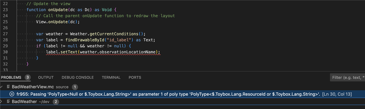

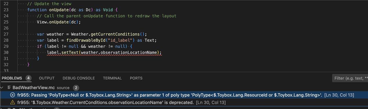

  • The discussion with type checking is just another variant of the same attitude towards bugs.
    You don't like type checking, you don't see the value in it, therefore you think nobody else needs type checking either.
    In my opinion, if everyone used type checking at level 2 or 3, it would get rid of a lot of bugs (assuming that they don't just use typecasts to sweep any problems under the rug, which is kind of an issue with Garmin's flavour of type checking tbh.)
    Clearly Garmin disagrees with you about type checking, since they enable it by default.
  • Anyway my original point was that enabling type checking and enabling api has check removal (both by default) are different kinds of issues:
    - if type checking prevents your project from compiling then it’s an obvious problem that stops you from continuing unless you either fix your type issues or turn off type checking. It’s an in your face problem. And again, enabling or disabling type checking in itself does not change the behaviour of your app at runtime
    - api has check removal *silently* changes the behaviour of your app without warning. The flag isn’t even part of the VS code extension’s settings UI, unlike type checking. Furthermore, the default setting of “enabled” produces behavior that almost no dev wants (afaict)
    Two completely different scenarios imo. This might come as to a shock, but many devs actually prefer typescript to plain JavaScript, which means there are devs who like type checking. Sure, there are also devs who prefer JavaScript without type checking.
    The difference is I doubt theres a significant number of devs who want the default behavior where api has checks are removed at compile time.
