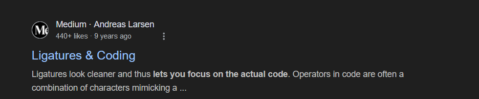

    Sorry for the screenshot, the forum has been code blocking us for months now.
    The actual text is "timer != null". It's displayed in the screenshot as "timer null" due to a (somewhat controversial) coding font feature called ligatures.
    Personally I can see both sides of the argument. On the pro-ligature side, they look "cool" (or at least they did 5 years ago), and they arguably focus on the meaning of the code as opposed to the individual characters. On the anti-ligature side, they can be confusing and obscure meaning.
    https://www.google.com/search?q=ligatures+code
  • Outside of the context of coding, it's somewhat similar to how phones, Microsoft Word, and macOS will change straight quotes to curly quotes, and double hyphen ("--") to em dash, except ligatures are display only. (With ligatures, the underlying text is unchanged, it's only the display of the text in supported IDEs that is changed.)
    In the future I should probably disable ligatures before taking screenshots of code. However, when I take a screenshot of non-trivial code, I usually also include a link to the actual text on pastebin, where ligatures are not an issue.
  • The actual text is "timer != null". It's displayed in the screenshot as "timer null" due to a (somewhat controversial) coding font feature called ligatures.
    The forum won't let me edit the original comment, so here's my edited text:
    "The actual text is "timer != null". It's displayed in the screenshot as "timer null" due to a (somewhat controversial) coding font feature called ligatures, which combines multi-character coding symbols such as "!=" and "==" into a single character, when using a supported font (such as FiraCode or Cascadia Code) and app (such as VS Code, neovim, iTerm2 and Windows Terminal)."
