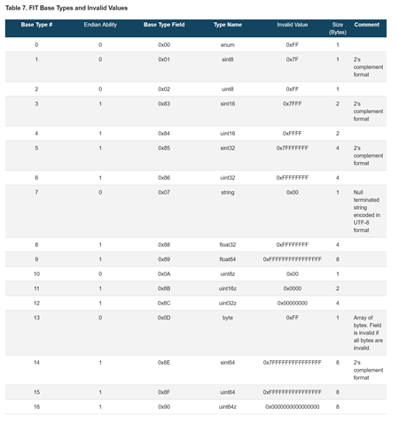

Assuming that the underlying value in question is an integer, it wouldn't be possible to use NaN as a special invalid value, as NaN is a float. Sure, in Monkey C, a given field might have a mutable type, but this might not be possible or feasible in the underlying C implementation, or in the activity FIT file specification. [Quantities like altitude and heart rate are written to activity FIT files.]
It's annoying that this isn't documented in the context of Connect IQ, but I think what you're seeing can be explained by the invalid values in the FIT protocol specification (see below).
I guess it would be nice if the Connect IQ framework would intercept these invalid values [even if they're part of the underlying implementation] and translate them into something like null, but that's probably not gonna happen.
One conceivable advantage of the current scheme is that if the dev happens to read HR data (for example) and write it to the FIT file as a developer field, the value of the developer field should match the value of the native field at any given point. [As a counter-example, it wouldn't be possible for an app to write null to a FIT file. The closest thing to "writing null" would probably be to write the invalid value.]
[https://developer.garmin.com/fit/protocol/]
