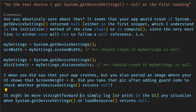

    On the real device I get System.getDeviceSettings() = null at the first reading. Only the second reading delivers the object.
  • And the 1st time is from the constructor of the app class?
  • Sorry for the post-as-screenshot, but the forum hates me
  • I agree. I think you expect it to be 480, but it might be something else. In some edge devices there are virtual buttons, that decreases the height, maybe something like that is also done to the width.
  • Unfortunately, the thread has become rather confusing. And stupidly, I have described two different issues. In addition, I copied various blocks in the code snippets as a test and created additional ones - in a word: it has become too confusing.
    Let's just describe the one case that happened on my device and was reproducable (not on every start).
    It is the issue of which I have posted pictures.
