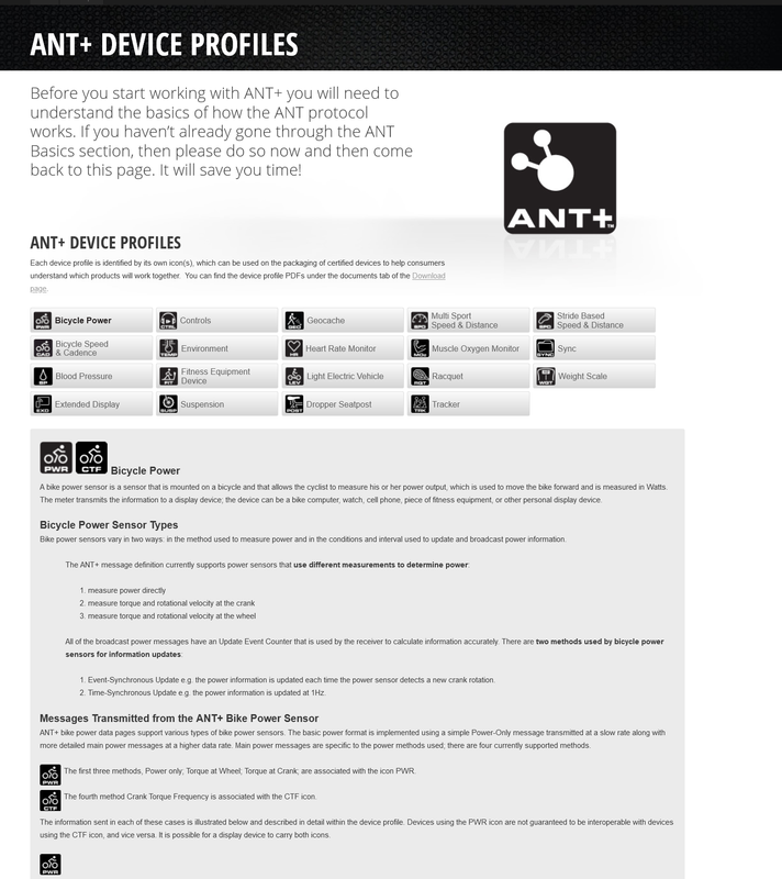

As a matter of fact, the ANT+ device profiles page specifically refers to "Bicycle Power", and the bicycle power profile description refers to things that are specific to...wait for it...bicycles.
Bike power sensors vary in two ways: in the method used to measure power and in the conditions and interval used to update and broadcast power information.
The ANT+ message definition currently supports power sensors that use different measurements to determine power:
1. measure power directly
2. measure torque and rotational velocity at the crank
3. measure torque and rotational velocity at the wheel
[https://www.thisisant.com/developer/ant-plus/device-profiles#521_tab]
> Torque and speed data (optional)
> Torque and Cadence data (optional)
> Torque Effectiveness and Pedal Smoothness (optional)
It's not "just watts" for bicycling power, either.
