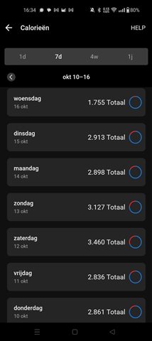

I made a simple app for mothers to track the breastfeedings. The short-term goal was to see what *** should be fed next, but now I want to add this data to Garmin Connect, so you can see the history of the feedings. This is especially useful for the first few weeks of the baby, where it is crucial the baby gets fed enough times.
What I would ideally want is a way to get a list of the last feedings in Garmin Connect, but a simple graph with from -1 to 1 (where 1 is left and -1 is right for example) and simple spikes of when the baby is fed would be fine as well.
