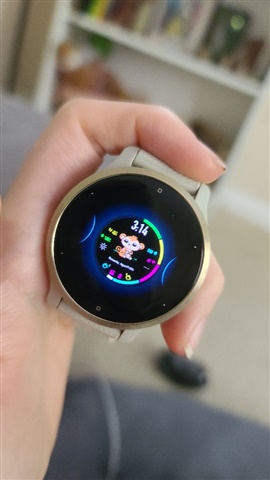

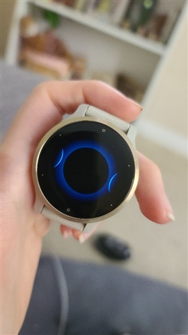

  • Here is a picture of the conditions that cause the crash: turning off all phone connections and bluetooth and Restarting the watch. When it pops up it shows a blank watchface instead of popping up. Only when you click on the blank watchfaces from the gallery view do they then run the watchface to crash, which then uploads the crash report to the .bak file in a large stack.
    When the bluetooth and phone connections are turned back on, the watches then appear to go back to a working order.
