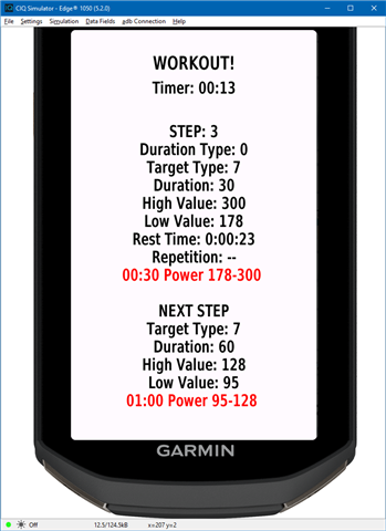

  • I reopen an old thread because I need help (once again)...
    Meanwhile I built a datafield for workouts which works fine, but I fail to get repetitionNumber.
    To help others understand my problem more easily, I've created a small project for workouts and attached it here.
    I'm also attaching a workout FIT file here that includes the repetitions.
       has helped years ago how to get repetitionsNumber, but it does not work in my code. So, apparently I'm doing something wrong.
    Here is the part of the code, which is not called because in line 104 of the project  curWOStep instanceof Activity.WorkoutIntervalStep is not true. (Here line 7)
                var curWOStep = Activity.getCurrentWorkoutStep();
                if ( curWOStep != null) {
                    stepKind = curWOStep.intensity;   //  1...Rest, 2...WarmUp, 3...CoolDown, 4...Recovery, 5...Interval
                    stepNotes = curWOStep.notes;
                    var stepInfo = curWOStep.step;
                    if (curWOStep != null && curWOStep instanceof Activity.WorkoutIntervalStep) {
                        repNumber = curWOStep.repetitionNumber.format("%0d");
                    System.println( "Reps: " + repNumber);
    WorkoutStepTest.zip

    Hopefully you can help me...
    Thanks in advance!
