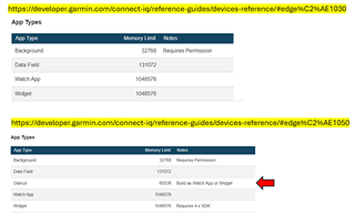

    This came up in another thread, but the newer Edges (including Edge 1040 and Edge 1050) absolutely support glances, and they absolutely use super apps (this can be confirmed by looking in the compiler.json device file and noting that “widget” is no longer listed under “appTypes”, but “glance” is.) Both Edge 1040 and Edge 1050 only list the following appTypes in compiler.json: “background”, “datafield”, “glance”, and “watchApp”. Again, “background” and “glance” aren’t separate app types from the POV of the end user, they’re just smaller components of other app types.

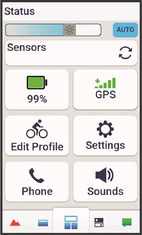

    - the widget interface seems to be a page full of tiles which don’t necessarily take the full width of the screen (similar to the iPhone control center), for non-training related things like battery level, wi-fi, settings, etc. Most tiles don’t display any information beyond the name of a setting that will be changed when the user taps on the tile. This does not seem to correspond to the Garmin watch concept of “widgets”. The closest thing on a Garmin watch to this is the controls menu (on 5-button watches, a circular menu of settings that’s accessible by holding the LIGHT button)

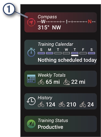

    - the glance interface seems to be a scrollable page of full-width informative tiles or pills. It’s very similar to the watch concept of glances, where each glance typically shows training data (like training status), health data or sensor info (like compass). I’m sure that CIQ glances belong here. The manual also says “tap on a glance to view more information” (the same way it works on a watch)
    Edge 1050 Widgets: https://www8.garmin.com/manuals/webhelp/GUID-08ACA9FC-DEE6-4C8D-8A95-F62181C512E9/EN-US/GUID-E741F23E-5A41-4490-8D17-8CB05FA626CA.html
    From the home screen or during a ride, swipe down from the top of the screen.
    Edge 1050 Glances: https://www8.garmin.com/manuals/webhelp/GUID-08ACA9FC-DEE6-4C8D-8A95-F62181C512E9/EN-US/GUID-3B7DBF2A-1E1E-40A2-8CF6-84128AAA4230.html
    Glances provide quick access to health data, activity information, built-in sensors, and more.
    • From the home screen, swipe up.
    This is very similar to what you’d see on a watch, except the watch only has room for 3 glances per page, and that the available resolution is obviously limited on a watch compared to an Edge
