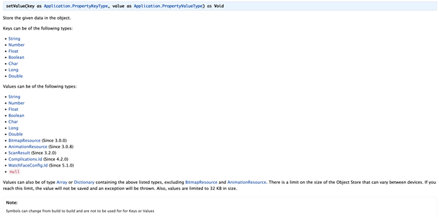

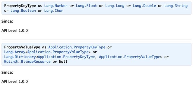

  • Yeah if you search ConnectIQ/Sdks/**/bin/api.mir for "type PropertyValueType", every SDK [*] except 8.1.0 has this definition:
    type PropertyValueType as $.Toybox.Application.PropertyKeyType or $.Toybox.Lang.Array<$.Toybox.Application.PropertyValueType> or $.Toybox.Lang.Dictionary<$.Toybox.Application.PropertyKeyType,$.Toybox.Application.PropertyValueType> or $.Toybox.WatchUi.BitmapResource or Null;
    [*] at least every SDK which I have installed and which has type info in the first place (the oldest I have which fits the bill is 4.0.6)
    type PropertyValueType as $.Toybox.Application.PropertyKeyType or $.Toybox.Lang.Array<$.Toybox.Application.PropertyValueType> or $.Toybox.Lang.Dictionary<$.Toybox.Application.PropertyKeyType,$.Toybox.Application.PropertyValueType> or $.Toybox.WatchUi.BitmapResource or $.Toybox.BluetoothLowEnergy.ScanResult or $.Toybox.Complications.Id or $.Toybox.Application.WatchFaceConfig.Id or Null;
    The changelog for 8.1.0 says this:
    Bug Fixes
    • Update typing for Storage.setValue() to include all allowed value types.
    The changelog for 8.1.1 says nothing about undoing that change, so I'm guessing the change was inadvertently undone. EDIT: then again, it's possible that it was undone on purpose, as PropertyValueType is used for both Properties.setValue() and Storage.setValue(), but the above change should only apply to Storage.setValue() afaik [*]. It seems that the correct fix would be to introduce a new type that's only applicable to Storage, such as StorageValueType.
    If the change was truly undone on purpose, it's a shame the changelog doesn't say a word about that.

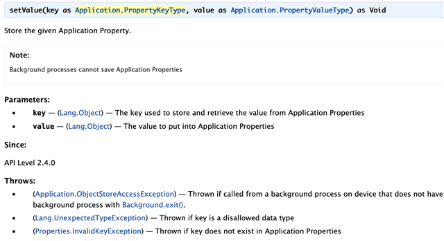

    [*] ofc I'm just basing this on the fact that the API docs for Properties.setValue() doesn't have a list of extra things can be stored in properties beyond the normal "primitive" Monkey C types and standard containers. Then again, PropertyValueType still includes BitmapResource even though the docs for Properties.setValue() don't say anything about that, either. (Contrast with the docs for Storage.setValue() which mention that BitmapResource can be set since CIQ 3.0.0). Does the lack of an explicit mention of  BitmapResource for the Properties.setValue() docs mean anything? Are we supposed to just look at the docs for PropertyValueType type and take it at face value? The docs for PropertyValueType don't mention anything about BitmapResource only being valid since CIQ 3.0.0. What about the fact that the Storage.setValue() docs also talk about AnimationResource being valid, but that wasn't reflected in the change above.

  • developer.garmin.com/.../Properties.html
    developer.garmin.com/.../Application.html
    developer.garmin.com/.../Storage.html
    I think that Garmin should update the docs for Property.setValue and PropertyValueType to make it explicit which types are available for Property.setValue, and what CIQ versions they are available in -- just like the docs for Storage.setValue.

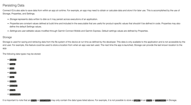

    As a bonus, I think the core topics doc could be updated, too:
    https://developer.garmin.com/connect-iq/core-topics/persisting-data/
  • The problem here is that a ScanResult can be saved to Storage, but not Properties, and PropertyValueType is used for both.  The doc used to be clearer about this, but can't find it right now.
    So if PropertyValueType didn't allow ScanResult, it caused a warming/error if you tried to do it with Storage, which is not an error, and it looks like in 8.1.0 where It would work for Storage (correct) but also for Properties (an error) so they checged it back
    Looks to me they need a second definition (StorageValueType) for Storage as the valid types are different between Storage and Properties.
