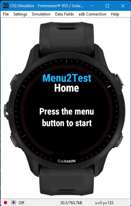

    Here's an example that modifies the SDK Menu2Sample sample so that the sublabel of the Toggles menu item displays a counter that increments every second. I've tested this in the sim (fr955), and a real Forerunner 955.
    In the Menu2Sample, the MenuTestDelegate class creates a Menu2 when the user "presses the Menu button" at the top level (e.g. hold UP on 5-button watches). I modified the class to:
    - store references to the menu it creates and the first item of the menu ("Toggles")
    - store an integer counter (starting at 0)
    - start a timer when the user presses Menu
    - when the timer expires, counter is incremented and the label of the Toggles item is updated with the current value of counter
    Complete MenuTestDelegate.mc source:

    Simulator output:
