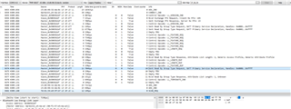

    As I see in the BLE sniffer (82540 dongle + wireshark) the garmin connects to the 2. device and try to reach some characteristics, and after terminating the connection with "device already paired" exception.
    I assume that, Garmin BLE API does not compare the devices via advertising data -> but from other yes ( what my device misses) that can be a reason for the reconnecting and discinnecting events.
