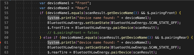

  • Unfortunately I am coming back to this discussion as my above solution is not working correctly.  Buggy code was hiding the issue and led me to believe our app was pairing the the second device successfully.
    The issue is narrowed to the following snippet (still very similar to above):
  • Had to break this reply up due to forum length limits, sorry.
    I did find one other discussion with a similar issue, however, there the issue was limited to pairing of a single device.  The issue is happening on line 59 or 67, dependent of which device is paired first (the second device is where problems happen).  Here, the first device is pairing correctly with no issues, as shown in the below debug console .bak/.txt file.

    Here when the scan result is found and a `device` object is assigned to `$.rearTire`, initially the object is not paired.  However, the pairDevice() call of line 67 eventually calls `onConnectedStateChanged()` after which the device assigned to `$.rearTire` becomes paired.  On the Edge device view there is a debug message shown on screen to indicate when this is successful.  Everything is all good.  The problem happens when pairing the second device.
    When pairing the second device (in this case to `$.frontTire`) line 59 assigns a device object to `$.frontTire` but `BluetoothLowEnergy.pairDevice()` never calls onConnectedStateChanged()`, as shown in the below debug console .txt file printout.

    The last debug lines just repeat and `onConnectedStateChanged() is never called.
    Note, the device MAC address have been verified as different in nrfConnect.
    I do not understand why the BluetoothLowEnergy.pairDevice()` call never calls `onConnectedStateChanged()` for the second device object.
    Any direction or advice would be appreciated.
