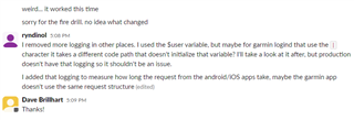

  • Strangely.... as you likely know, there are two steps to the process. I perform a makeWebRequest where I pass the username and password with a method =>Comm.HTTP_REQUEST_METHOD_POST and that apparently works. I get a STATUS=200 and the access and refresh tokens back. Then I follow up immediately with a method => Comm.HTTP_REQUEST_METHOD_GET and that fails with the -400 error. The ONLY difference between a successful attempt and these "400" failures is the expanded username with the |running part added to the string. Any thoughts? Yes I go thru GCM.
  • Are you trying to pass this as part of the url, or in the params field?  Sounds to me like it's part of the url.  Try moving it to params.
  • Params field. I actually got in touch with the server admin/developer. Now it works. So it was def on the backend, not CIQ or CGM. Thanks!
