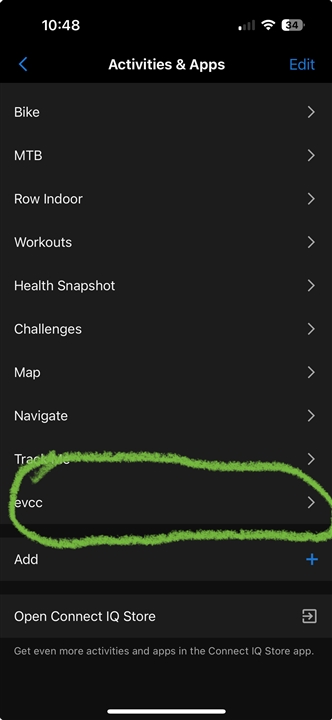

I have just created my first proof-of-concept app (a widget with a glance). It works well, both on the CIQ simulator and on my actual watch, an Epix Pro/Gen 2/47mm, after side loading it by copying the .prg file to the Garmin/Apps folder. On the CIQ simulator I can call up the properties and it shows them fine. However, when I open the settings of the app in the Garmin Connect app on iOS, the watch crashes and reboots.
Any ideas of what I could be doing wrong? The app is a debug built, but not sure how I can access any relevant debug information that may help?

  • My side loaded app still appears in the Connect app, and when I open it there, the watch crashed.

    No, it is my first app, and it is in its early stages, I never submitted it to the app store. I side loaded it, and then it appeared on the Garmin connect app on iOS.
  • iOS... well, I only have android, where you would only see the app's name and a general icon, and at the moment you couldn't even click on the app). In the past (and hopefully again soon) you would be able to click on the app and there you could at least delete it. As far as I know there shouldn't be a Settings button there in case the app is not downloaded from the store as you say. So it's very strange. Maybe this is some feature that iOS Connect IQ knows, but it wasn't implemented in android????
