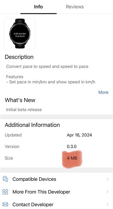

I've made a very simple and tiny app called Pace Calculator. Since it's so simple and I want to support as much as possible, it only relies on API 1.2.0. I use SDK version 6.4.2.
I noticed that the size for the app is listed as a whopping 4MB which sounds crazy given that the whole codebase is ~170kb (source here). This also means that a lot of devices can't install it due to size limitations.
I'm building an optimized version with monkey-c-optimizer. Could this be due to supporting so many devices (128)? How can I see what's causing this?

  • Removed speed.png and now use the the 65x65 image as icon (4KB). In total source + resources is 23,7KB. I tried exporting it with the regular plugin (not the optimizer) and the .iq file comes out at 4MB which is also the size Connect IQ reports in the app after reinstalling the latest version.
    So I don't think an of the pictures here is the problem. Even with speed.png still in use that's only 147KB and shouldn't result in a 4MB big app.

  • Ok it seems like I was wrong. Even though the image isn't used, having it as a drawable in drawables.xml is definitely the cause here. I don't know why, but having that one even without using it makes a lot of the prgs ~950KB each but often just ~120KB. The complete iq file becomes 150MB though. I can't find any single prg being 4MB though so not sure what that's coming from?
    By simply removing the line from the XML makes the iq file end up at ~3MB and the installed version (on my device) is 25KB.
    I wonder if this is a bug worth reporting. It makes no sense for the compiled prg for a single device to become 4MB just because you include a file at 150KB. I can think of other apps with custom fonts and other resources reaching 150KB without being extreme.
    Do you think this is a normal behavior or something worth bug reporting?
    Thank you for the help, in this case it solves my problem but I don't know how I would solve this if I actually needed 150KB of resources which doesn't sound that weird in my opinion given the current generation of devices.
