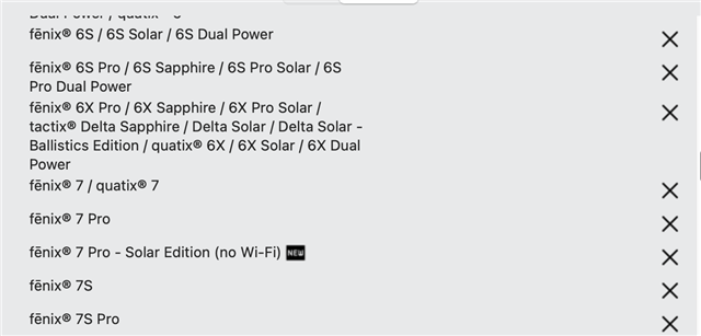

    Open the SDKManager, click on the devices tab.  You can see if there are updates in any of the 3 categories, or drill down and see if there is an update for a specific device.

    You are suggesitng
    I have the devices tab open, but the Fenix7 does not appear as a "New" (or updated) device.:
    I am confused.
    [EDIT]
    I am still confused, but now, without doing anything, my app runs on fenix7_sim.
  • The Fenix7 series are devices with CIQ 5 (System 7), like Kyle mentioned.  Won't see "new" unless you didn't have the device in the past.
    I don't see "new" for the f7 pro (no wifi) as I've had that devices since it was first announced
  • I don't see "new" for the f7 pro (no wifi) as I've had that devices since it was first announced
    That's because I have just this week returned to do the housekeeping since my last update back in September.
