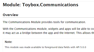

  • Thanks. Just need to reconcile API 5 and System 7 and SDK 7 and CIQ 5. Sounds like these are all the same. My immediate issue is I'm running out of BG memory for a large JSON packet. I can't pass it into Background.exit(data), and I can't Storage.setValue("data",data). Out of memory. So I was hoping my Target Devices like an EDGE 1030, 820, etc, would now be able to to handle COMM in the foreground under API 5.
  • Older edge devices like the 520,820,530,830,1030 are CIQ 3 and will not be getting CIQ 5, so this will not help you with those.

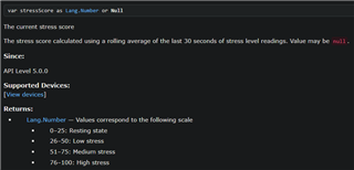

  • Is there an easy way / summary to see all the new functions in 5.0.0 ? E.g. stress score is now in ActivityMonitor.Info
  • There is the System 7 announcement, and also in each SDK is a readme file with all the Release notes back to version 0.0.1 of the SDK
  • I don't see this specific change (stress score) documented in either of those places. I'm guessing there might be more things that were added and it would be nice to know what they are.
  • There are times that it's just a matter of going through the API doc (yes, it can be a pain), but imagine a doc that listed this for each version of the SDK over the last 9 years.
