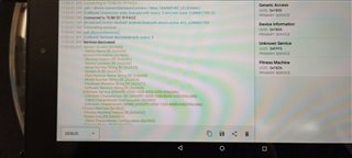

nrf connect does manage to pair the device, the callback after the pairing it is called very fast as shown in the log file
