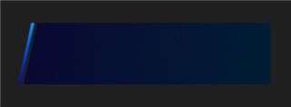

  • I tried to poke around the json file and see if there might be any paddings anywhere that would add up to the 139 number you got through trial and error, but I'm coming up short... have you been able to test on the actual fr265 device, or are you still working in the simulator? I know I've seen jim mention over and over that the simulator doesn't always replicate the real devices 100%, so I'm curious if these heights are off in the simulator json vs the real devices.. or if the MenuItem auto sizes itself if you add a subLabel to it?
    there's an nLists_Blue.png file in that directory which looks like this, is that what you're seeing in the CustomMenu?
    have you tried explicitly passing in :theme=>null as part of your options Dictionary when you initialize your CustomMenu? I wonder if at the very least you could turn it off...

  • I calculated the 139 on the simulator
    and indeed that blue box is what I see on all menu’s on the 265…
