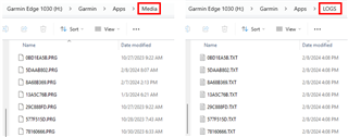

The mappings from PRG name to app name are present in garmindevice.xml -- you can extract the mappings programmatically if you can access the device "file system" (via USB Mass Storage or MTP) and parse…

It does work, but he's glossing over the part where you would look in garmindevice.xml to see the filename of the PRG installed from the store.
You can either sideload the app while the store version is installed, and use the filename of the store app, or you can remove the store app before sideloading and rely on the fact that the sideloaded app name will not change (with the possible exception of truncation to 8 characters.)
I didn't mean to say the garmindevice.xml wasn't changed, but that my app wasn't in there (even though I did start it and I know it's the right version because I have a version const that I display on the main view just to be sure I'm debugging the latest build).
But I think I made it work now. I don't know why it didn't work previously. I "downgraded" to the store version from Connect IQ app, then I did see it in the xml, noted the filename, and then sideloaded the new build and added the txt file, and I can finally see the logs.

- When you sideload an app, and an app with the same ID that's been installed from the store does not currently reside on the device, then the app filename on the device will be unchanged (with the possible exception of truncation to 8 characters, not including the extension.)
- When you sideload an app, and an app with the same ID that's been installed from the store currently resides on the device, then the sideloaded app will take on the filename of the store app

You don't need to see them on the watch. Use CIQ Mobile or GE and uninstall them that way. When you then sideload "MyPrg.prg" that will be the name for the stuff in data, settings, and the name for the txt file..
