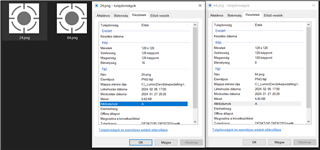

I only added 128x128 pictures, as for the "Device 64 Color" image, I uploaded a 64-bit depth image, and for the "Device 24-bit Color" section, I uploaded an 8-bit depth PNG. The Connect IQ system accepted the images, so I thought everything was fine. However, they did not appear on the watch, so I tried using JPG format. These did not appear on the device either, so I attempted to upload black-and-white PNGs with a 16-bit depth everywhere to rule out any depth-related issues, but the black-and-white logos did not appear on the device either, even after reinstalling or synchronizing.

  • What you see in the last image you posted is the launcherIcon for your app, as seen in the manifest.xml file for your app.  The IQ you see is the default for samples and those started with "New Project".  You find the file in resources for your app, often resources/drawable/launcher_icon.png
