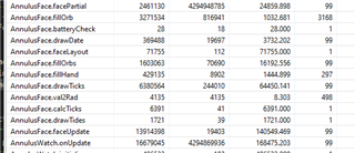

Pretty sure something isn't right here:
From the device PRF file. Watch face is continuing to tick away like nothing is wrong.
Another week, a new bug.

  • In sim diagnostics it's currently less than 10ms,  up until recently per the watch PRF it was less than 6 ms. The sim and watch don't match, I've posted on this before. It's an analog watch face, so the one clipping region size varies by the second. I've been trying to tweak time and code size with the hopes of getting it to run on more devices, and apparently I broke something. Now it's all sideways. FWIW, it runs on my FR235 so maybe space isn't such an issue, but because there aren't any seconds it's not really a direct comparison. However, it seems like a number around 2**32 should be suspicious and maybe indicate something wrong with more than just user code.

    Each hand is two separate polygons and onPartiaUpdate is drawing the second hand. Adding up the functions that onPartialUpdate calls the times seem where I would expect, but for some reason the total doesn't equal the sum of the parts.
  • There appears to be a "feature" in the watch firmware because the PRF files look like they have some corruption:
    AnnulusFace.fillHand does what it sounds like, draws two polygons to make a hand. It is only ever called in onUpdate or onPartialUpdate, so why is it in the background PRF? Also, getURL is this:

    So why does it take 1.4 seconds to build a string, or are string operations really that bad?
    At least the time for onPartialUpdate is back to a believable valure:
    Looks like some sort of weird firmware bug unless someone can offer a better explanation.
  • This appears to be an integer overflow issue. Would you happen to have some code / CIQ project you could share that reliably reproduces this?
  • It's not consistent. I see it in the simulator too.
    Could it be because of this?
    Or this?
    As I look at it I'm thinking underflow but being displayed as unsigned.
