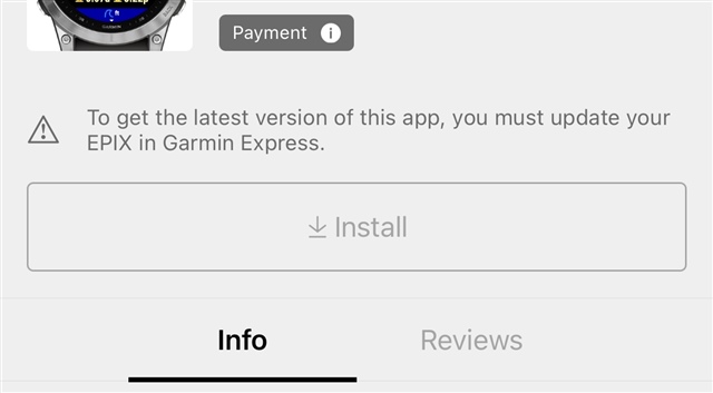

  • I thought the store would not let you install an app that was built with an API level that is not compatible with the FW.  No?
  • For devices that don't support complications, all the complications code is excluded.
    You don't "build with an API level", aside from specifying minApiLevel in the manifest (which you have not mentioned). If you're trying to imply that (for example), apps build with CIQ SDK 6.4.2 can only run on devices with API level, that's absolutely not the case. Assuming you build with the most recent SDK available at any given time, the devices that can install your app are determined by:
    - the devices specified in manifest.xml
    - minApiLevel specified in manifest.xml
    For example, if you specify a minApiLevel of 3.3.0, then all devices specified in the manifest which support 3.3.0 (or higher) will be allowed to install your app. Any user with a device with firmware less than 3.3.0 will be prompted to upgrade (if applicable). If a device doesn't support 3.3.0 at all, then they won't see your app. One situation that's come in the past is when an APAC (Asia-Pacific) version of a device only supports much older firmware than the WW (Worldwide) version. This is because APAC devices typically receive updates more slowly than WW devices.
    In this case, if you specify a minApiLevel that's too high, you may end up excluding the APAC version of a device while the WW version is still included. (For some newer devices, the same firmware is used for both APAC and WW.
