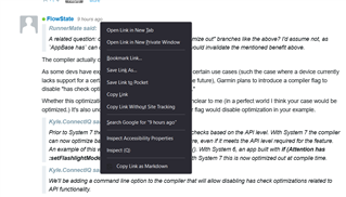

    linking exact comments would be welcome in the forums.
    You can link to individual comments as above: [https://forums.garmin.com/developer/connect-iq/f/discussion/347053/instinct-2x-has-api-lvl-3-4-0-instead-of-4-2-0/1713731#1713731]
    Right click on the date/time of of a comment to get a direct link. e.g. "9 hours ago" in the following example:
    [https://forums.garmin.com/developer/connect-iq/f/discussion/356290/best-practices-for-build-exclusions-exclusion-based-on-api-level/1714330#1714330]
    Also, if you quote a comment by selecting text and clicking "Quote", the quote block will also be a link to the comment. You can even use this trick to quote text from another thread, as long as that thread still allows replies. Create a draft reply in the other thread, quote the text you want, and copy the quote block (don't save the draft reply.)
