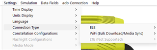

    In general, wifi isn't enabled on a watch (edge devices are a bit different) the majority of the time.  Pretty much when you are downloading new firmware or something like music.  On watches, it's just used for bulk download/media sync.  You can see this in the sim, under settings>Connection Type
