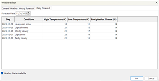

In the sim you can change the daily forcasts. using this tab:
