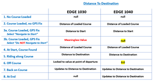

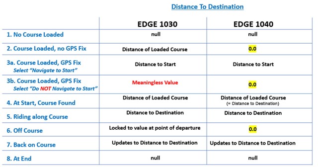

  • This is really helpful to ensure my logic works on the x40 series. Do I have this right for the 1040? Thanks!! Yellow is where the 1040 and 1030 differ?
